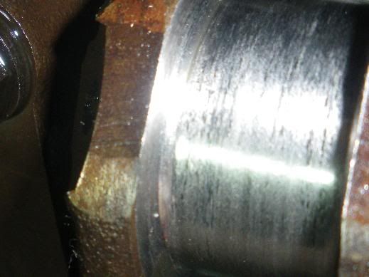

After my SVA the other day my engine developed a seriously nasty noise. I'e had a look inside and found that No 2 big end does this - Crank
When I took the cap off I found that there are no shells left at all and the crank looks like this - Photo
Any opinions on whether that is still serviceable with new bearings, or not, please?
Neil

cloudy
posted on 19/7/09 at 01:29 PM Reply With Quote
Not a chance I'm afraid, I don't think you'd find oversize bearings that big!

big_wasa
posted on 19/7/09 at 01:31 PM Reply With Quote
Nope need a fresh engine

RAYLEE29
posted on 19/7/09 at 01:33 PM Reply With Quote
Hmm looks bad, you need to measure it with a mic and check the size it may clean up wth some wetndry but it really needs to be within about a thou of the original size

omega0684
new crank, new shells, new rods
jpindy3
posted on 19/7/09 at 01:34 PM Reply With Quote
oh bugger,new engine for you then,is it the 4age,you should be able to find one quite cheap,

Nash
posted on 19/7/09 at 02:37 PM Reply With Quote
There are engineering companies who will build up the journal and machine it back to STD diameter but the cost may well be prohibitive. May be cheaper to find a replacement engine and start again. Even if you rebuild you need to find out why it was starved if oil

tomprescott
posted on 19/7/09 at 03:33 PM Reply With Quote
As nash says there are people who will build up the journal, but you'll need a new crank anyway so you may as well just get a new engine. We sent away an engine at work to get some machining done on the journals (granted an engine much rarer and worth a LOT more than a 4age) and it came back after a month with us a few grand poorer!

Neil P
posted on 20/7/09 at 04:01 PM Reply With Quote
Yes, as I thought really. I went and ran a fingernail across the surface, it would just mince any new bearings put in there, I'm afraid.
Oh well, looks like I've a job to do then!
