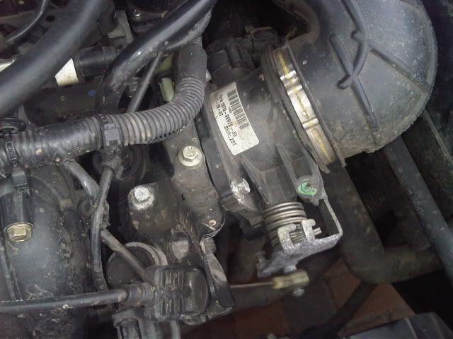

More questions regarding my Duratec HE engine (that i am coverting to LPG), Does it have a MAF?? There is nothing upstream of the throttle body and cant see anything afterwards???
