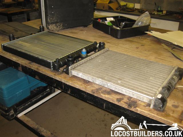

Here's a picture showing the relative sizes of the two Polo radiators. The larger one is fitted to 1.7 and 1.9 litre diesels so should have all the capacity I need. The inlet and outlet stubs are at the same centres so that should help the fitting.

Neither fitting the higher capacity radiator nor the addition of Water Wetter has had the slightest effect on running temperature.
To be honest, I never thought the Water Wetter would work but I am disappointed that the new rad didn't cure the problem.
