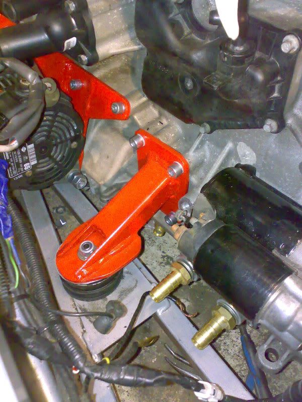

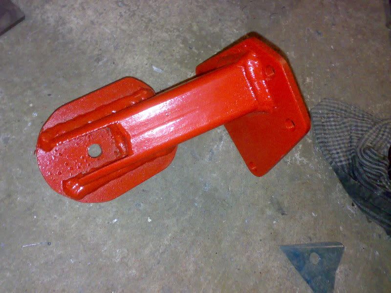

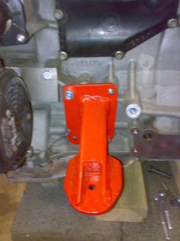

I do intend on producing some of these however until I take ours off and reverse engineer them I can't help you - can't even really give you any dimensions at the moment. Not much help I realise but this is what we did:
We also run a rose-jointed 'steady' bar off the front cover (where the engine mount would have been) across to the top chassis rail.

Thanks for that Dan they look just the job.
I've seen some Caterham one's but they are expensive as you can guess.
But the picture is very helpful thanks.
