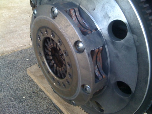

Took my engine out to paint it and was a bit surprised at how small the clutch is.
Is this standard for a 2.0XE???

ooh, no that looks a bit special to me!
mine (although a later ecotec) the clutch is a lot bigger. mine uses a sierra plate, i forget what size.
don't think i got pictures of mine, but thats not standard i don't think
this is a bit more like it

Cheers Blake... the guy I bought the car from rattled through the spec when we met, but it was never written down. I then promptly forgot!
I've tried getting back in touch with him to find out more, but he's gone quiet!
I remember him saying he had a mate who worked for Alcon and that he had supplied the brakes and some other 'stuff'... maybe thats where
the clutch is from.

| posted on 18/1/11 at 03:20 PM |
some one has spent MEGA money on that clutch
twin plate 7 and a half inch by the look of it, prob abot £700-£1000 worth of clutch

| posted on 18/1/11 at 04:49 PM |
Special clutch and quite a tasty bit of gear luck you.
Should be some markings on it somewhere I would imagine.

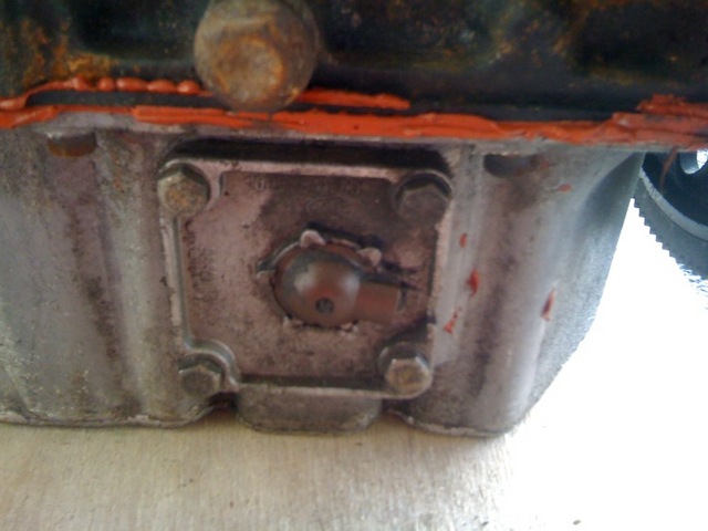

And any clues what this is on the sump?
It's Evolution Baby!

Yep that'll be the old oil level switch to let you know when to top it up. ( mainly for women as men do check oil regularly )

you're a jammy sod!!!
That is an expensive clutch!!
We've just paid £600 for something similar in the kadett c turbo, plus 120 quid for the billet flywheel!

Thats the Oil level sensor
and that Clutch is Big money
Don't take this the wrong way but There seems to be an awful lot of sealant on the mating flange of the sump and it would be worth removing the
sump and making sure none of the sealant has found its way into the Bottom of the sump
*If* it clogs the oil strainer or gets into the oil pump it won't have a happy ending
I stripped a Zetec engine once which was similar and the Gasket sealant had blocked half of the oil strainer

Cheers. I was thinking that I might as well change the oil-pump whilst the engine is out, so will see if there is any gunk inside!
