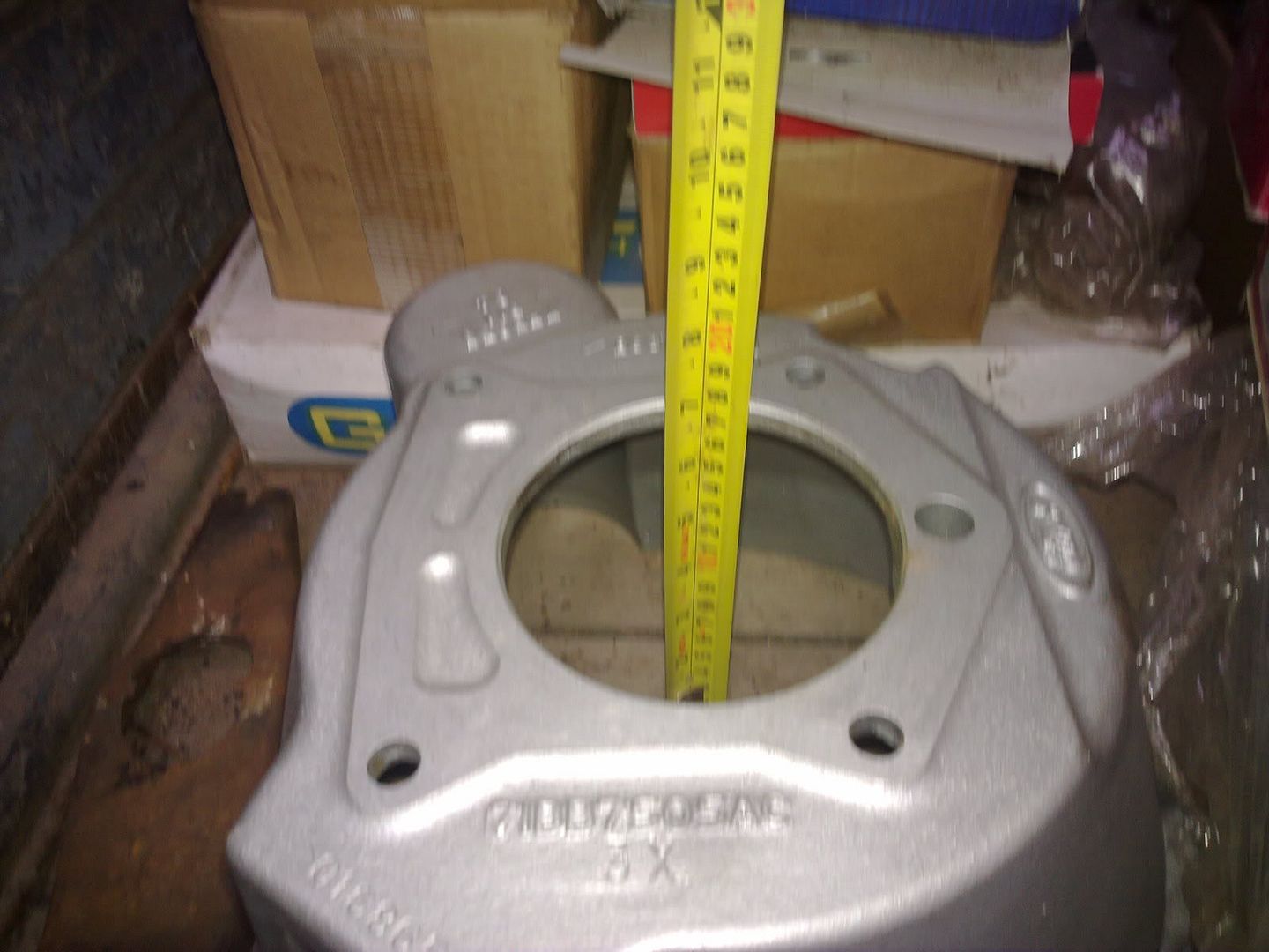

mcerd1
posted on 22/2/11 at 10:55 AM Reply With Quote
right here's some stuff that might help you workout what you've got
drawing of the normal 'short' type 9
my own 'short' bellhousing (measures about 7" so matches the above drawing)
link
link
link
click on links for huge versions
