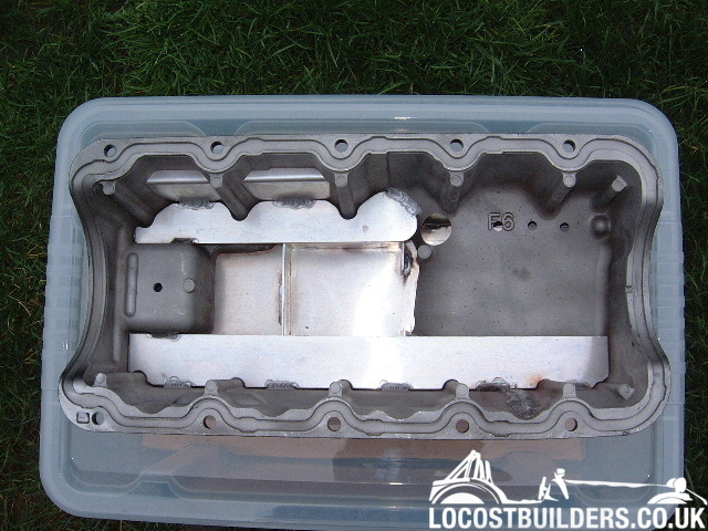

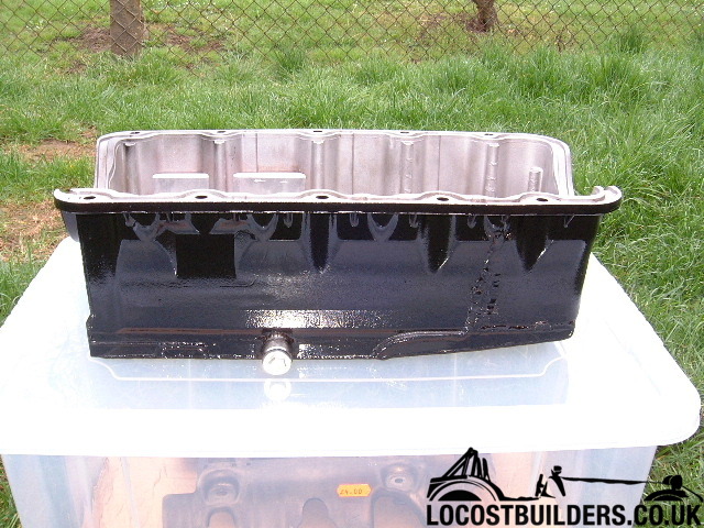

scholar engines sump

big_wasa
posted on 2/6/11 at 04:43 PM Reply With Quote
yep but the photos give you an idea of depth and the baffles.
