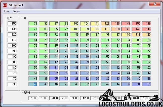

I have turbo and ITB and it is interesting. It turns out that if you run MAP only then the MAP signal doesn't reflect the air-flow changes that
you get with ITB opening. I have logs that show clear modulation of AFR with TPS where the MAP shows no such changes (see below).
I am therefore running blended (a MAP table and a TPS table, that are multiplied). This is a pain to set-up, but I have a few tricks (well basically
a big computer and some modeling software) and the AFR looks great.
I am told that if you use "multiply by MAP" then you can run with Alpha-N, but I haven't tried that yet.
I suspect with a single throttle body, the solution is to use MAP but I have no practical experience.

With a single throttle body you have a nice big volume in the plenum which will average out the fluctuations in air flow and provide a stable MAP
signal.
With a throttle body per cylinder you have a tiny volume between the throttle and the inlet valves which obviously causes large changes in pressure
through the various engine cycles e.g. under small throttle openings vacuum will be high during the inlet stroke, but as soon as the valve is closed
air will be drawn past the throttle and the vacuum will disappear, or at least be considerably reduced. Therefore you only get a representative
pressure reading for a fraction of the time.

Normally map, but i use TPS for off-boost and a MAP correction table for on boost using megasquirt 2
The best solution for throttle response, this is what Dave would have done i expect.
This is also what most manufactures do, the Audi TT is done as above.
