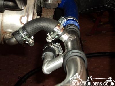

2008 r1 cooling system
hi can someone check this for me please as the coolants not circulating and temps up to 100degrees
this hose goes to the top of the rad and the small tee comeing off it goes to the oil modine
hose from the rear goes to the bottom of the rad and is filled from a tee which goes to the header tank
any ideas?

my oil cooler outlet go's into bottom hose and that go's to bottom of rad the rest is the same on bottom hose
top hose set up the same but the t bit gos to the header tank not to oil cooler
Kev...........

thats great thanks il give that a go, wheres the other take off going?
Kev99
| posted on 27/1/12 at 01:44 PM |
the other take of go's to the header tank on bulkhead
