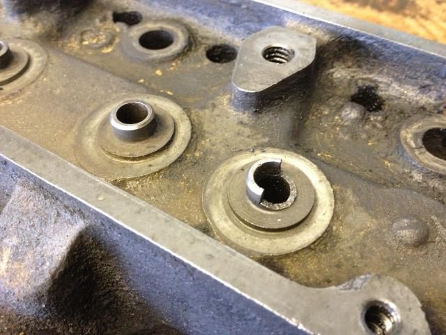

I have a 1300 x-flow head in the garage that was given to me a while back and in order to start clearing some space i thought i would give it a clean to see what's what.
After dismantling i have found that one of the valve guides has been damaged (the bit that the valve stem seal connects to at the top of the guide)
Now my question is, is it possible to just have the one guide changed or is it advisable to have them all done, i have now intention of using the engine myself but once cleaned up it might be of some use to someone else
Also, how much should i expect to have a guide changed, i know an engine/machine shop that is local that will do cash in hand jobs, and as i can't imagine that this is a major job, i would imagine it shouldn't take long to replace?

It is really not a major job the most time consuming part is re-cutting the valve seats.
As they came from the factory xflos didn't have valve guide but the valve ran directly in the head casting.

if the guides were machined into the head casting does this mean that i might as well weigh it in?
Damage below

It is a fairly procedure to drill out Ford cast iron heads to take interference fit valve interference fit valve guides.
