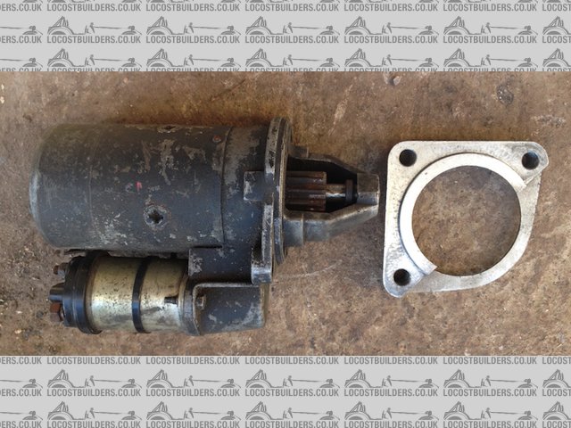

Can anyone help identify this starter motor which I found it at the back of the garage. It seems to match up well enough with the Caterham K Series
adapter pictured...
PS - my engine is not here just now, so I can't do the obvious.

Visually the starter looks identical to the Bosch Pinto one on my Zetec engined car. Worked perfectly well in a X-Flow as well.
What is the part number?

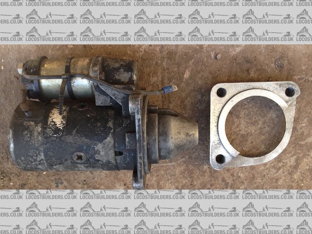

Can't find a number.

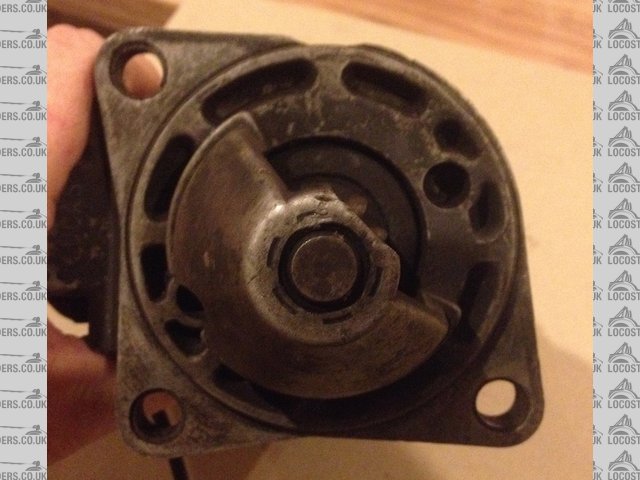

| posted on 8/1/15 at 08:00 PM |
It's face...
It's Evolution Baby!

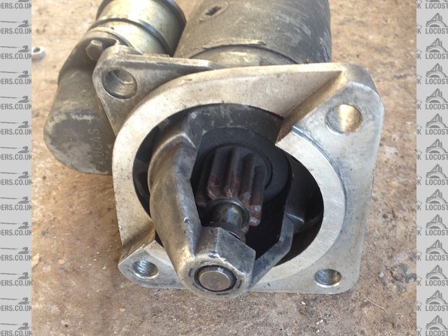

Found a bit of sticker under the grime with 'Lucas' on it. Can also see 'Lucas' stamped on the solenoid.
No other ID marks though.

Nose looks to short for Pinto
Recon it's a Sierra CVH

I've never had a CVH in my garage, so it's unlikely.

My instinct was cvh Sierra.
