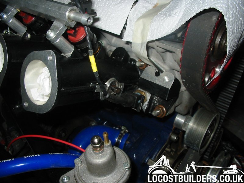

Chris, on the front of the manifold there are two openings in the head infront of no1 where you can put a bleed from that side of the head to stop air pockets forming in the head. I've used one of these to relocate my temp sensor to!
Ned.
ps here is a pic of where i've put the temp sensor and the machined bit above it at a slight angle can also be drilled for a bleed.
