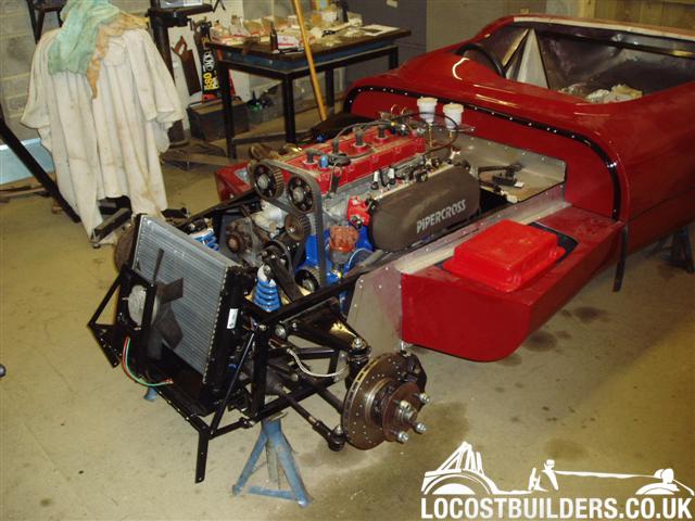

Has anyone had any problems using the cable tie type radiator fan mounts from CBS? I know several people on here are using them.

I've used them several times - never had a problem - just keep an eye on them as they tend to slacken off / stretch a little at first.

I asked the same question on this site about these fixings and was advised by a number of contributors to avoid them like the plague as they come loose and can damage the radiator core. I did in fact take the advice and fabricated a small frame on which to mount the fan and am very pleased with the result.

Believe me, they will eventually wear through the rad core, stranding you on a cold wet November Sunday night

I am sure I was one of them. Get your lazy butt down to B&Q and pick up some tube or angle iron and make a bracket.

I've used the tie thingies and thought the same about the rad core.
There are rubber tubes that go round the ties though to protect the core...........
I don't know, as I have never done it this way before but equally know of plenty that have with no probs.
Has anybody actually had a rad failure due to these, or is it just speculation? (on a new rad by the way!)

Mine didn't have the rubber sleeving - just cable tie type things. Maybe a few inches of rubber sleeve might have saved me a 5 mile walk that night

I agree completely, and don't like the setup, but to "make a bracket" for my installation is not so easy.
To do it right would need a sheet of 3mm ally and either the engraving machine or lasering.
Any other way will be heavy and there is nothing convenient nearby to attach it to!
If the rubber pipe stops the chaffing that wears through the rad tubes then problem solved anyway.
Certainly the tie fixings are what my Pacet kit came with and they are fitted to hundreds of cars, but they do have the rubber sleeves which it sounds like not everybody has!
