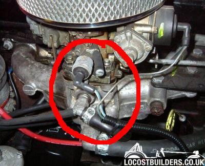

There is another spade connector on the front of the carb (faces away from the engine) I think it’s a solenoid because if I put power to it, it flicks in or out.
Question.......
1.) What the hell is it for?
2.) What the hell do I connect it to?
Cheers in advance,
The Baron
Just found this picture in the archive... what does this connect to????

Its an Idle solonoid. It cuts fuel off in the idle circuit. connect it to ignition supply.
Steve.
[Edited on 22/11/06 by stevec]
JohnN
posted on 22/11/06 at 11:06 PM Reply With Quote
It's the idle fuel solenoid, needs +12v when engine is running to allow fuel for idling. Isolated when the ignition is off
