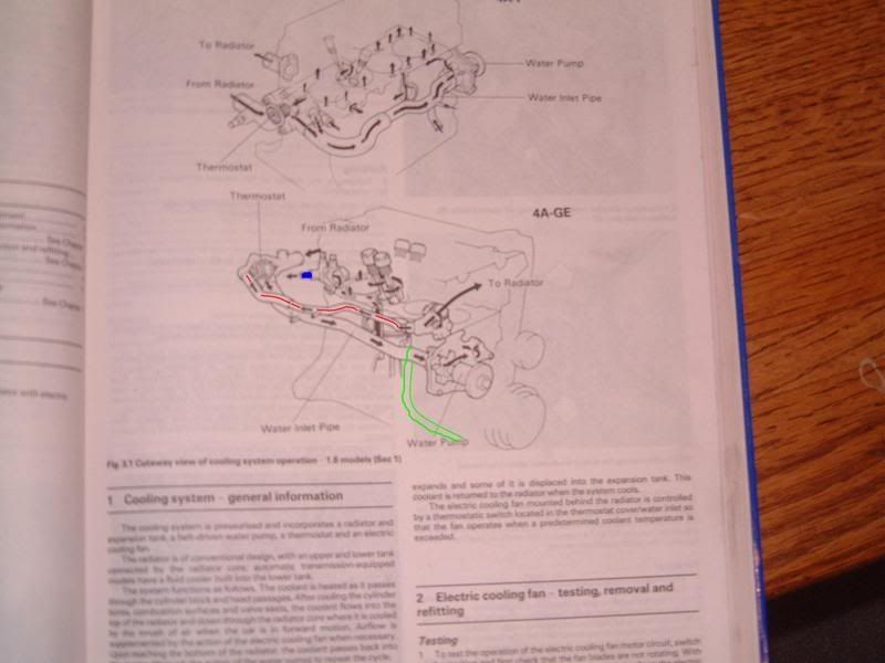

I'm coming to the plumbing stage of my 4age installation and have a few questions.
This is the haynes diagram, sorry not very clear.
Is there any point in the pipe I have highlighted red? If not things would be easier as I could bend the green pipe as shown and have a pipe straight from the radiator through a thermostat to it.
Where should I route the blue one?
Are the pipes to the throttle body needed? ( I have a cut down toyota inlet and TB)
Any suggestions would be very much apprieciated.
Andrew
posted on 9/1/07 at 06:59 PM Reply With Quote
If the stat stops the water in the green pipe you'll have no circulation round the block when it's shut. If it doesn't there will be nothing to make the water go through the radiator.
Andrew Beattie
posted on 9/1/07 at 07:38 PM Reply With Quote
Thanks for the reply, I see now that getting rid of the red pipe stops circulation when stat is closed. I was also wondering where people have put the header tank into the system?

i would use the thermostat, i used the original housing, but turned the pipe around so the bend would be sharper, look in my picture archive may be clearer there, i also cut the small bore pipe which you asked did you need. i done it this way to keep it as standard as possible so the water would flow corectly.
hope you understand what im saying as it hard to explain

Thanks for all the replies. I think I've now got my head round it. Pointing the radiator return in the other direction as you said seems to solve a lot of problems.
The only thing I'm still unsure about is what will happen if the pipes to the throttle body are missed out, which will happen if I cut down the two soild tubes.
posted on 10/1/07 at 12:16 PM Reply With Quote
It will probably run better without a heater on the TBs, cold air is better for fueling. If the pipes are flowing water they will just need connecting together or blanking off. Have a look on Billzilla to see if he has any useful stuff.
