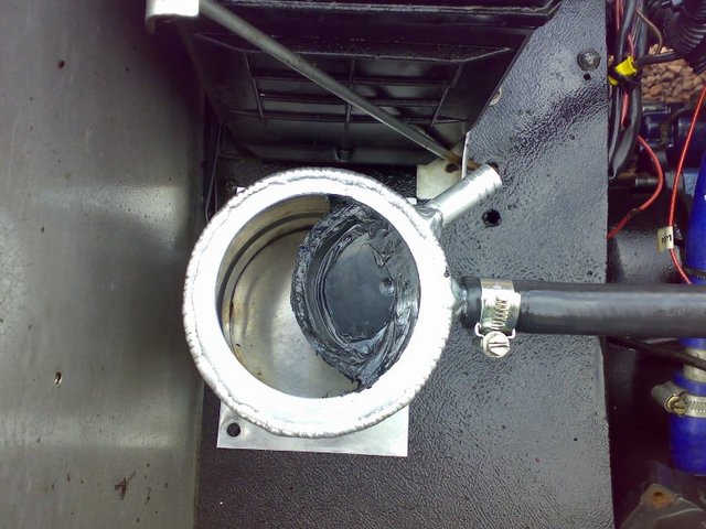

Here is a pic of the modded tank showing the internal baffle (drain back to tank not shown on this pic).
What im really trying to find out from those with no issues on a Pinto is whats the main difference between your set up and mine. Im sure there will
be a clue there somewhere.
Maybe i need a bottle that is deeper (ie 1.5l pop bottle for a trial) in which i can fit the 2 pipes in directly near the bottom of it and not use the
top which is at least quite high, smallish diameter and tapered.

designer
| posted on 28/9/07 at 03:23 PM |
There is nothing special about swirl pot design.
The only requirement is that the inlet enters the pot tangentialy, hence the name swirl pot.
Liquid entering then swirls around the side of the pot.
No baffles are required.

nitram38
| posted on 28/9/07 at 04:30 PM |
I think that I have sussed your problem.
Both your breather hoses should enter from the top of your tank.
Both relieve crank case pressure.
If the block breather is at the bottom of your tank, it is blowing any oil that collects, out.
You should not let oil from your catch tank to drain back to your sump via your breather anyway.
You should throw it away and top up with fresh.
I have used simple tin cans with the breathers just dropped through the top of the can and tied so that they do not sit on the bottom in the oil.
I think for racing you need at least a 1 ltr tank but some regs might specify bigger.
Here is a simple catch tank that you can adapt to your own:

DarrenW
| posted on 28/9/07 at 05:04 PM |
Nitram,
Ive just been talking this through with Mookaloid. Looks like you may have hit the nail on the head.
Both inlets enter at the top. The baffle sort of converts them to bottom feed but problem no. 1 is the baffle is too long.
I understand about draining back to engine, but in my case it is good oil collecting in the tank. I think my 2 main issues are;
1. The drain i have fitted enters the engine via a modded oil gallery plug. This is basically part of the crankcase and subject to the same pressures
that the cortina trap sees. On one hand it does allow oil to drain back but mainly when engine is off. When running, crankcase pressures can also
force the draining oil back up = splatter and mess - ie its acting as a combined breather and drain which in hindsight isnt a good plan.
2. The top of the catch tank is open / too large.
I dont think blocking the drain off will totally solve my problem as for some reason my engine circulates more than average oil (and this is the 2nd
engine to do it). However if it were to drain below oil level in the sump then the crankcase pressures wouldnt try and vacate through it.
Im now planning to shorten the baffle and maybe try some foam / sponge at half way point or try a new bottle as in your pic (this is what i tried to
show in pic 3 of the file but not as good as your sketch). I know Andy D uses a similar bottle to your sketch and gets little oil in it. Im hoping
that a bottle top(eg bike water bottle / small flask), being tapered and smaller entry, will suffice being left open.
My other theory is that my shortened sump design may not be optimal WRT baffles etc. Maybe the oil is being allowed to move around too much and being
closerto the crank could be getting whipped up - this is probs why its sensitive to overfilling.
Thanks for the suggestions - giving me something to think about for the redesign. It has also been suggested that i try clear tube so i can see where
the oil is coming from.

You want to have a crankcase that breathes without pressure.
The original oil breather was an emissions device where air was drawn through the block to remove the oil vapour that would normally vent to the
atmosphere and instead burn it off.
On a road car it is fine to have this arrangement, but not on a modified engine or race car.
Catch tanks on race cars are compulsory to help prevent oil spills on the track if you blow a hole in a piston etc.
The fact that your oil has turned to vapour is telling you that it has be heated too much and will have lost some of it's viscosity and
therefore is not much use to your engine.
That is why I said throw it.
A normal road car would have burnt this up and you would have had to top up your oil anyway. So you are not saving anything by returning it to the
sump. All you will be doing is diluting the good oil.

quote: Originally posted by nitram38
Have you removed the little box from the side of the block breather?
You should run your hose straight into the block and remove the box.
It contains gauze and a little flap valve.
If the flap valve is left in this causes a build up of pressure.
Unless your catch tank is very low (lower than the block outlet), you should not get more than 0.5mm of oil in the catch tank.
You just need a pipe from your rocker cover cap and one from the block with no drain.
You can even T the pipes together so that only one pipe goes into the catch tank.
Your problem is probably the location of the extra drain, which is forcing oil into your catch tank.
The only oil in there should be only condensed oil from the vapor from both breather hoses.
[Edited on 28/9/2007 by nitram38]
Not sure what you mean here to be honest. My original breather was 1987 vintage sierra A PCV with 2 tiny outlets. I started by taking out the spring
plunger. Then pulled it out completely and replaced with the Cortina trap (large oblong box that i think just has an angled baffle plate inside).
Catch tank is sitting on a horizontal bit level with bottom of scuttle (highish up).
Before fitting the drain i tried Teeing the 2 pipes together and running seperate. This si why im so bothered - i keep thinking ive tried most
permutations but something must be alluding me. Im sure ive missed something simple but too close to the problem so blind.
2b_pablo
| posted on 28/9/07 at 09:26 PM |
exactly the way I have mine, pipes both run to the bottom. burton vented filler cap and cortina trap.
I get a little oil coming out the dipstick but only a little.
No bother really even on track.
[Edited on 28/9/07 by 2b_pablo]
nitram38
| posted on 28/9/07 at 09:29 PM |
Just get rid of the drain and try it with the pipe from the filler cap (I am assuming that you have this) and one from the side of the block.
I would even get rid of the Cortina trap as it could be causing a blockage.
I sounds to me that your system is getting pressurized and that is forcing oil into the tank.
As the drain level is in this oil, it is then blowing it out of the tank.
If you do all of this and you are still getting oil thrown out, then do a compression test on your cylinders.
Too much pressure could be your rings are worn and you are getting excessive blow-by.
Pablo, lift the pipes off the bottom of the catch tank and then you shouldn't get any oil out of the dipstick.
If the pipes are touching the bottom, they are not breathing and it is pressurising your crankcase
