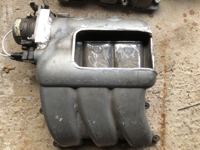

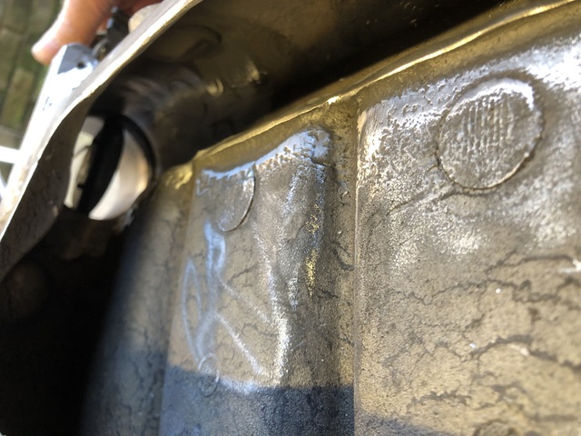

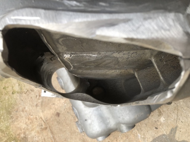

I spent this morning looking at my Jaguar engines (I have two of them and yes I know it's greedy) which was spurred by Steve's problems, for those that don't know I am now getting closer to doing the paintwork, the engine has been in and out multiple times and three different engine mounts have been fabricated. I initially thought that the ST200 manifold would work but it ended up too close to the bulkhead, heater and nearside bonnet hinge so I had a rethink and after buying an X type one I decided to carve up a ST220 inlet manifold. As you can see I sliced of the inlet tract up to the plenum and removed the raised section for both access and bonnet clearance, the closed end was cut open and a 25mm block of aluminium was welded in after drilling a 65mm hole in the centre. I used a burr cutter to blend the aluminium block into the interior of the plenum.
Modified ST220 inlet manifold
Modified ST220 manifold
Inlet manifold shelf
You can see that there is a shelf that runs the length of the plenum, the offside bank of cylinders is fed by the lower section and the nearside bank by the upper section. The throttle butterfly works with one side of the flap feeding the upper shelf and the other side the lower. the shelf has been shortened next to the throttle body by about 15mm to aid air flow. I will try and polish the upper surface of the shelf to improve airflow.
I had a good look at the engine with the S type manifold still and that open pipe feeds a small 3mm flexible hose about a metre long but I have no idea where it went to. The rubber elbow on the PCV was good on both engines, however I think it would be easy to fabricate a rigid steel or copper one

that all looks very impressive fab work. I'm trying to avoid very much of that although I did have to get an adaptor made for the Throttle body.
I suppose the pipe you are referring to was my mystery hissing pipe near the lower IMT valve? It's now blocked off. There was a small tube in that area that's no longer there. It went to the electronic fuel pressure sensor. Not sure why that was there but even my fuel pressure guage has a release tube and valve for when you disconnect or reset, so I imagine could be something like that. But I'm not using that as Ive got a mechanical pressure regulator with a vent tube back to the tank.
Ive also got that tube to the crank case that I hear gets cracked. Mine seems to be in good condition but as of now it's not connected to anything else anyway.
