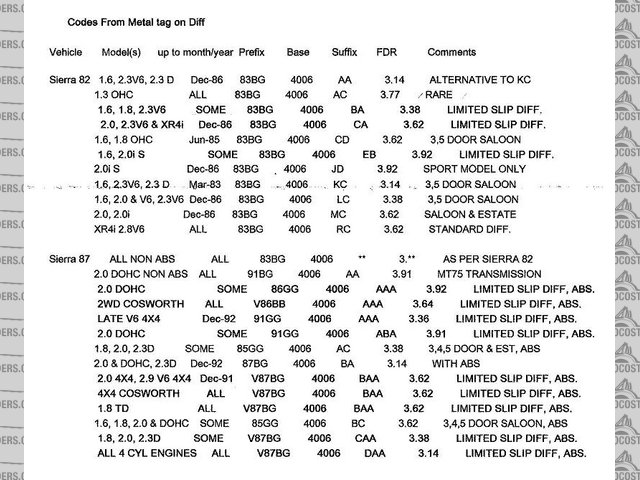

jacko
| posted on 4/10/14 at 09:24 AM |
Does this help you at all
  no2
jacko
Wildwest
| posted on 4/10/14 at 10:28 AM |
  no2
jacko
Thanks guys for your help.
Meanwhile, I managed to get the proper info : my diff has a 3.92 ratio.
Hope this helps to feed the database.
Huttojb
| posted on 4/10/16 at 06:52 PM |
Hey
Can someone confirm my ratio
My tag says;
83 BG 4006 CD
6 D28 D ? ?
Cannot read the last 2 values?
Thank you
Jason
