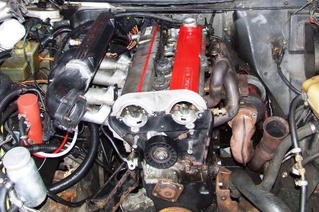

MT75's and props (Zetec turbo conversion)
I know its my first post - but have sent here by Google that many times, guessed its time I joined!
OK - firstly, i'm not building a Locost, but have a brace (3) Scimitar SS1s, so have some similarities in that they were hand built in Britain
and use Ford running gear (bar the Chevette front suspension).
What I am doing to mine is converting the 1600 CVH/Type 9 combo to a Zetec turbo and MT75. It's an early silvertop, and the MT75 is from a
Scorpio, so the hydro clutch version - that was a deliberate choice for two reasons..the starter moves to the inlet side (exhaust space is a little
limited) and also I want to use a Focus RS clutch (hydro clutch allows me to play with cylinder sizes to get a lighter clutch).
Back to the question in hand - what's the best way to attach a prop? I gather that behind the tripod is a splined output shaft, but can a type
9-esque splined prop be used? I don't have enough chassis space for the rubber donut (and I hate the things), but hear that there is a solid
conversion available, and to use a sliding section propshaft? Do i need to get a Transit output flange and speak to a prop supplier to make a prop up
(I intend to use Dave Mac in Coventry)?
All ideas welcome! If anyone wants to know anything about my setup, please ask..
