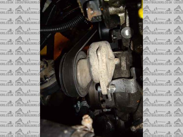

whitestu
| posted on 18/11/08 at 08:46 AM |
Blacktop Zetecs come with a tensioner pulley that will bolt straight onto the front of the block in the right place to act as an idler pulley.
All you need then is a bit of flat bar bent to shape to give a bit of extra support as the block only has one bolt hole for the pulley to connect
to.
Its not pretty but works fine and is dead easy to make.
Only downside is the ali cover needs to come off the front of the block.
Stu
| posted on 18/11/08 at 09:28 AM |
Thats interesting Stu, I searched round the block for somewhere to mount the tensioner but couldn't figure it out. Have you got any more
pictures of the right place with more detail please??
