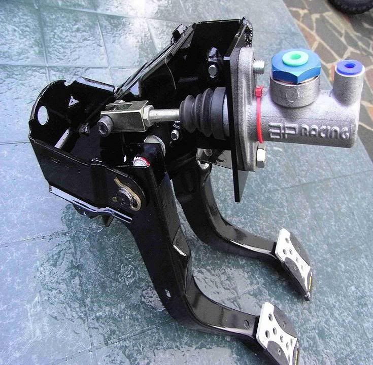

It doesn't appear to be that difficult to alter ford pedal boxes to hydraulic. Here's a picture I stole form the Cobra Club site
[img][/img]
