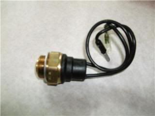

I just measured up the threaded bit in the Polo rad to see what size fan controller would fit in there, and it's a 20mm by 1.5 thread - is this an M22 size? that seems to be the most common controller fitting size...

I had a similar problem about a year ago of looking for a plug for the fan controller hole in a VW pattern radiator. I can't remember whether mine is a Polo or Golf pattern but the hole size sounds familiar. I couldn't find an appropriate bolt but found a locost solution in the form of a fan switch from a Mk2 Fiesta XR2 - I think. about £5 off the shelf.

Any motor factors should be able to supply you with the switch cheap enough.
There's quite a lot that fit - mine is Sierra Cosworth 7? degree so Ford and VW use them at least.

Yup, as above
M22x1.5
fits the following:

Oh and a Polo rad ...coz thats what I fitted it to

I just bought the polo one when I got the radiator..... worked for me (and I knew it'd fit ).
