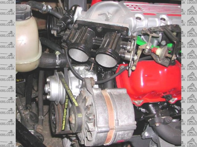

Dont know about the v8 but I had problems with sapce mounting my altenator on my v6 ford engine, ended up mounting it the forwad of the engine.
because its rectified it works in either direction. This may or may not help, thought it was worth mentioning

| posted on 29/1/04 at 04:33 PM |

sorry about that I appear to have sent that twice, there are more pics on www.alt-media.net/v6_locost

That, sir, is cunning. It looks like a very similar alternator to ours, so if it can go the other way round it may just work.
It's certainly worth a go!

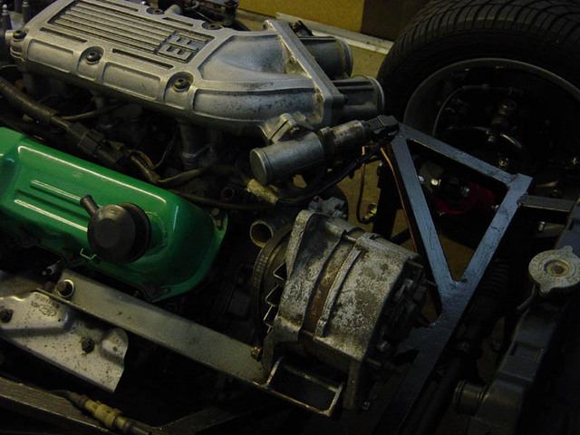

Donners90
| posted on 29/1/04 at 06:16 PM |
Not necessarily on TOP of engine
G3OFF is building a Viento with a TVR V8. On the Luego website there is a photo of the front of his engine and the alternator is mounted below the
level of the cylinder heads!! Maybe it's worth asking him where he got the bracket??
I hope you don't mind G3OFF, but I've attached this photo of your engine ...and mighty fine it is too!!

Alistair Mc
| posted on 30/1/04 at 01:11 PM |
stephen
Thanks for the segestion Looked at that first, my car is book width at the front and I had no room at all, this is why I had to go for the more
unconventional approach, works fine in car, bracket was a pain to make, the one in the image was a first prototype, its much stronger now
