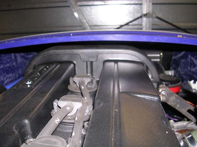

I cut the sump on my Blacktop level with the bottom of the bellhousing, raised the chassis on 30mm box section (I know slightly more than normal) and
this is the result.
  zetec height
I'll pop out to the garage in a mo and take some measurements.

The indy top rails are 25mm higher than book locost, i am though sure the zetec will fit in a locost with a regular bonnet and no bulge if using
TB's / carbs instead of the original injection system.
