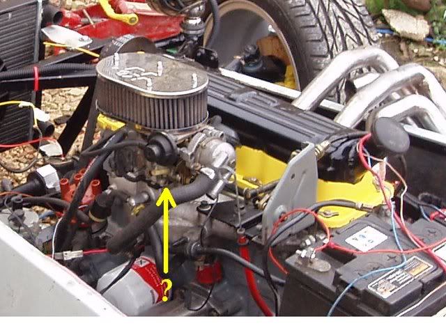

Hi Guys.
Misplaced my workshop manual AGAIN!!!
I got my SVA in the morning.
Just incase I have prob's with the emissions.
How do I make the engine run leaner?
Couldn't find the mixture screw, when I looked.
Too bl***y dark now, so thought I would ask here.

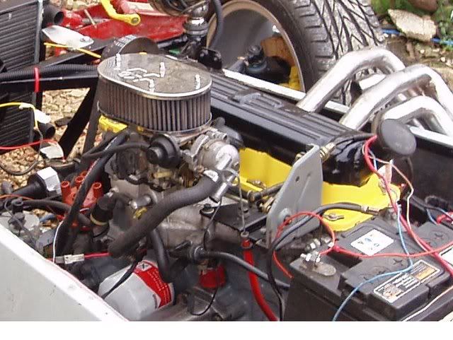

A pic would help.
Cheers David

If you look beneath the black diaphragm on the side of the carb there is a plastic tube (white) which is the idle speed adjustor , just below that is a small hole in the flange of the carb , that is the idle mixture screw
Is this it?
Also do you screw it IN or OUT to make the engine run leaner?

screw in to lean the mixture
screw it in fully not tight then screw it out 1.5 turns should be there then
