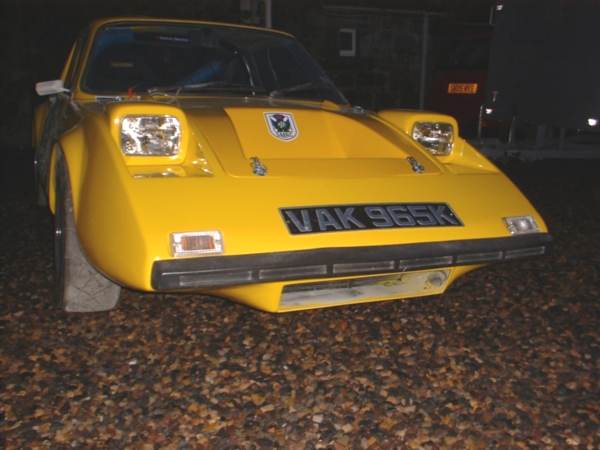

They are indeed lovely little units, keeping me happy in R40 for many years. It is very difficult to believe that the engines were out there in the
60's. Here's my (now sold) Clan (now doing something with a chap in Scotland),
http://uk.youtube.com/watch?v=uWoLpDMZFts
I'd even buy it back now, which says it all.
The engines themselves are incredible, yep, that 3 bearing crank will take a pounding. You can stroke them, add a spacer on the block, get it up to
1120cc etc., etc., only problem is cost. A 998 on an R20 cam, snorting through 40's is a great classic combination. It's just way
outclassed now compared to other powerplants of that size, but still a great historic toy.

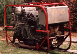

If I remember correctly they were even used on forces fire barrows to run a water pump for fire fighting, very powerful pump which would pick a person
up holding the hose with a 3/4" branch on the end, great fun would be had inching the revs up and seeing the shocked look on the hose mans face
as he realised that he was starting to fly.

yep - you remember correctly - there was a shed load of climax engine pumps on the bay last year.

Was your Clan on throttle bodies ?
It's just that I know soemone up here who has / had a yellow Clan on throttle bodies and minilites.
Incdentally, there is a Clan relevance regarding the Imp engine I was helping with.

Pretty certain that was the Clan Joe Johnston had last year - I had the pleasant task of doing some work on it - a beautifully put together car - just
did not comply with the 'historic' regs so he sold it on.

That's the car I was talking about Doug. There's a surprise ;-)
The one on the video under this one on youtube.
Only with Ian Longford driving it.
(Although strangely, he didn't manage to lock up the front wheels into the top corner for a change.)
I think the Clan was more suited to Joe than the Phantom - which is for sale again......

VAKattack!
Yep, it's a beautifully put together car (I did it). I still have the moulds for the front end, the roof and floor (I had to add the bulge to
get 6'2" in plus helmet). The crossmember, too, was all my own construction. The car broke across the floor when it landed after going
seriously airborne (I hit a bank and launched the thing).
Didn't realise it'd been sold on, if it does come up again, let me know. I have a partially built GSXR1000 subframe to slot it the rear.

The origin of the Imp engine was the same fire pump engine that became the Coventry Climax engine that powered Jim Clark to World Championship.

Wee Joe did not have a problem with the headroom - in fact I took out the dropped floor for him and re-painted the front end.
Designed in 1950 by Walter Hassan and Harry Munday, target was max 350lb complete with pump and 35 bhp.
Result was 180lb and 38 bhp. When CC stopped making the engines for the pumps they were replaced with Imp ones!

I had a Coventry Climax firepump with the FWB 1460cc version of the engine
Sold it to a guy who was going to use it in a historic Lotus single seater.
