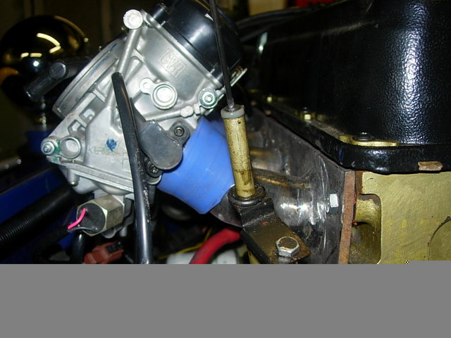

| posted on 24/1/09 at 05:31 PM |
I used the original carb inlet rubbers mounted on plates.
jacko
| posted on 24/1/09 at 07:42 PM |
I have used these silicon rubber for 3years know but some people say its no good with petrol
  carbs on manifold
Jacko
