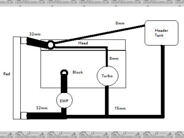

Can you draw diagram of you plumbing showing bore sizes?

I've tried to draw a diagram here: Rescued attachment rad.jpg

digrams looks ok but what has happned to the heater lines?. you can buy dye that changes colour if there is presence of exhaust gas in coolant.
