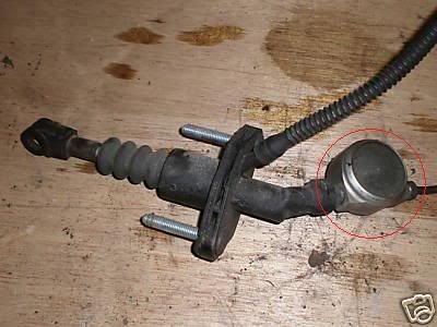

What is this?
What's this (circled in red)
I know VAG call it a frequency modulator (the one pictured is from an astra g) but does anyone know how it works and what exactly it does, most modern cars seem to have one between the two clutch cylinders

I know it as a damper - at a guess it's to stop you dropping the clutch too quick(doesn't do Dual Mass Flywheels any favours).

its a damper,stops you dumping the clutch too quick by restricting the fluid flow,BL used them and they leaked after a few weeks so we took them off and aimed them in the bin.....job done

I see what you mean but it's got hole straight through it the bore of the clutch hose so don't get how it can restrict flow really, I was told it was to prevent pedal vibrations but nobody knows for sure

It dampens out pedal vibrations , hence the name "damper"

very good, but above its referred to as a damper then stated to be a flow restrictor, again, no one really knows what it is then? or how it works? And I don't mean 'yeah it makes your pedal smoother' I mean, how is it valved / sprung internally

If it's a damper then there will likely be a diaphragm and a pressurised chamber inside. The shape would certainly indicate something like that.

I agree, its a damper to reduce pedal vibrations back from the clutch/flywheel.

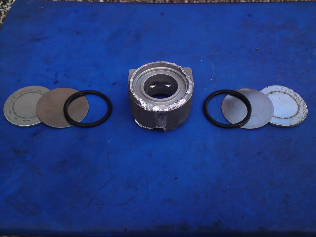

Just so everyone knows, I just split it and its just a void of fluid with 2 o rings sealed against the swaged in steel discs either side so it would appear to be a pedal vibration damper relying on the resevoir of fluid it holds to filter them out.
Nothing special or intricate and certainly not to prevent the clutch being dropped
