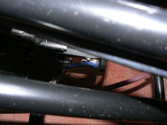

nitram38
posted on 2/3/09 at 06:53 AM Reply With Quote
I have used a "pull" wilwood slave and a 0.75 wilwood master cylinder on the Motaleira. (wilwood pedal set)
I removed the freeplay from the clutch arm. This is only there to help your hand on a bike gain some mechanical advantage before getting to the biting point. I added another lever arm with 67mm hole centre from the clutch pivot. The original arm is left as it attaches to the return spring.The slave has a travel of 34mm.
My clutch pedal is quite soft but has a long travel. I hate heavy clutches in traffic.
Not had a chance to drive it yet. I need to setup my gear indicator/veypor before I put the driveshafts in.
Different engine, but might give you some ideas
[img][/img]
[img][/img]
[img][/img]
[img][/img]
[Edited on 2/3/2009 by nitram38]

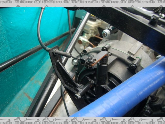

stuart_g
posted on 2/3/09 at 02:41 PM Reply With Quote
Here is the pic.
Not brilliant but you get the idea. Rescued attachment Clutch lever on engine..JPG
