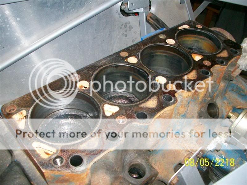

So, I'm sort of assembling this car and I'm getting ready to add a few bits to what was originally a pretty bare engine.
Anyway, being as I am a very well behaved person, I decided that yes, I would take the head off for a quick look inside.
This is what I found
and yes, there is a pronounced wear ridge on each bore

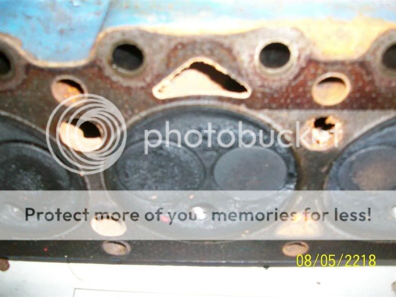

Have a look at this head,and note the inlet valve that is slightly open (it shouldn't be)
So, what do you think then? Quick wipe over with some WD40 and scotchbrite? Or does it need something slightly more intensive

how 'pronouced' is the ridge on the cylinder, possible re-bore and fitment with oversized pistons & rings?
does the head need rebuilding? new stem seals regrinding of the valve seats etc?
coolant pathways need cleaning by the looks of things aswell

I was expecting answers more along the lines of bury it, but yes, I expect it does need a complete rebuild.
problem is that that is going to add substantially to the overall cost, and unexpected too

Doubt it will actually run very well with that inlet valve anyway so I don't think just slapping a new head gasket on and praying is going to work. Just dressing the engine is going to cost more than sourcing a MOT failed but running well Mondeo.
