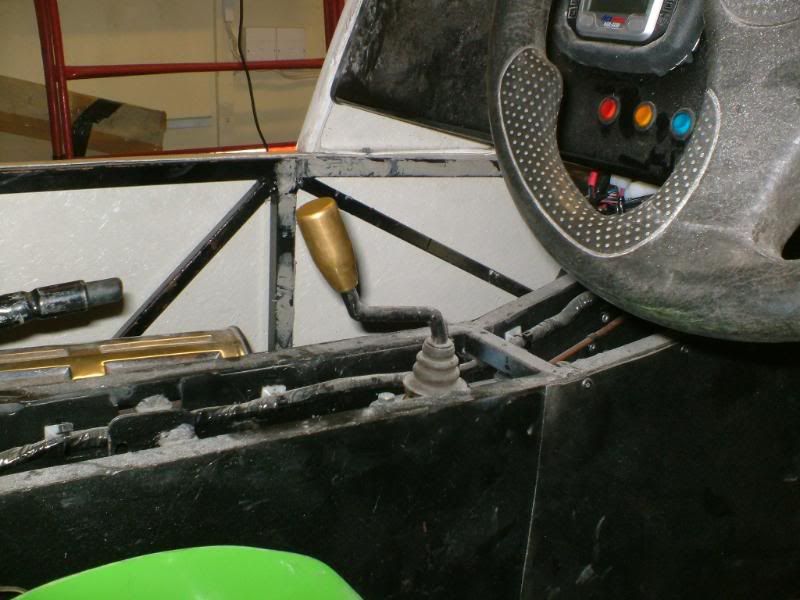

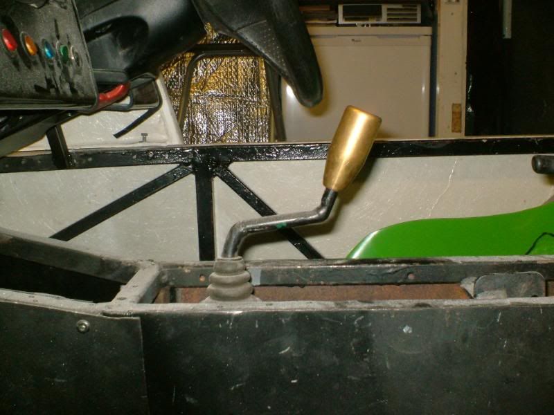

posted on 9/6/09 at 04:18 PM Reply With Quote
i fitted a remote gearlever and then cut and shut the existing gearlever to move it even further back...
posted on 9/6/09 at 04:56 PM Reply With Quote
you can see in this photo how small my knob is (fnar fnar)
