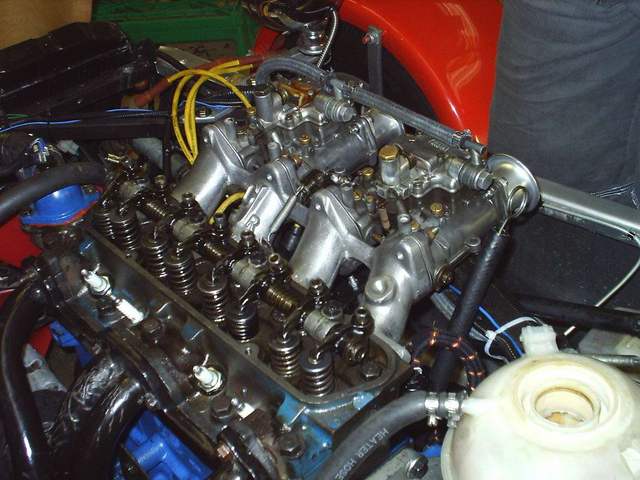

been there, done that
i had my intake machined on both sides for the carb to sit more level, and lower
![](/galpreviews/a91955-S3000004.JPG) ![Rescued attachment S3000004.JPG](/gallery/a91955-S3000004.JPG) Rescued attachment S3000004.JPG
scutter
posted on 10/3/04 at 05:29 PM |
Looking Good,
Mine now looks like this,
Image deleted by owner
Manifolds much shorter than before.
All the best Dan
