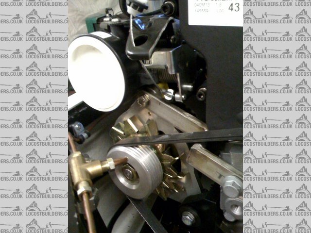

eddie99
| posted on 23/6/09 at 08:33 PM |
i can send my pics to emails. Chris im sending them now, maybe you can post them up for me

eddie99
| posted on 23/6/09 at 08:59 PM |
Lol hope it helps, its not the neatest of solutions but its not bad.... its a tight fit but it works and so does the throttle
Needs a bit of tidying up....
I have used original throttle body and intake by the way but its similar position to any other throttle bodies :p
Would be helpful if someone could post them from chris's photo archive :p

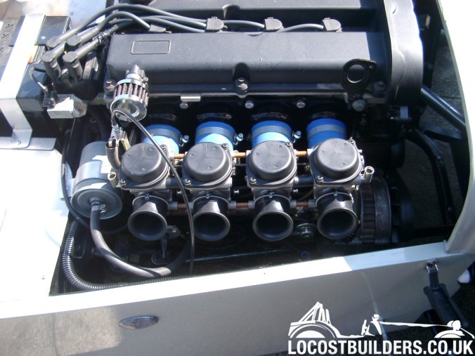

big_wasa
| posted on 23/6/09 at 09:08 PM |
mr duck 1
  Alternator 2

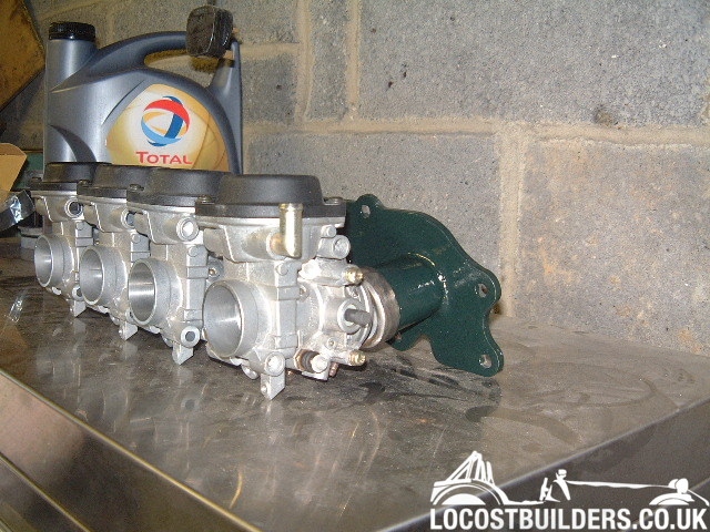

big_wasa
| posted on 23/6/09 at 09:10 PM |
mr duck 2
  Alternator
eddie99
| posted on 23/6/09 at 09:13 PM |
Thanks, sorry they are bad photos, quite hard to get a good angle now the engine is in the car
big_wasa
| posted on 23/6/09 at 09:36 PM |
Ive made a few zetec alt mounts. The denso is nice but would need droping a bit more or laying over to get mr r6 Tb's on stubby manifold to
fit.
The holes are 50mm apart and the back hole is 5mm lower than the front.
http://www.locostbuilders.co.uk/upload/DSCF0722.JPG
Ive bassed mine on tim windmills as the tb's are well matched to the ports.
The manifold plate is one of shorttracks and the hole lot comes in at around £100
