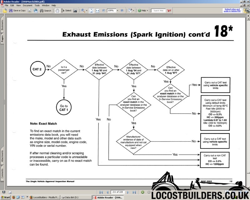

Has anybody got the following info please: For 95' onwards the SVA guy told me that the acceptable emissions at 2500-3000 rpm for a Fireblade
engine is CO = 0.3%, HC= 200ppm, Lambda= 0.97 to 1.03 and CO= 0.5% at idle. Has anybody got the figures for a pre 95' engine please. Barry

http://www.locostbuilders.co.uk/upload/2emissions.jpg

As detailed in BenB's document
I have the test results from my SVA in front of me - pre 95 Fireblade engine
The limits are
CO % Vol =3.5% Actual 2.81
HC ppm Vol = 1200 Actual 423
plus a visual smoke check.
all taken at idle = 1100 rpm
