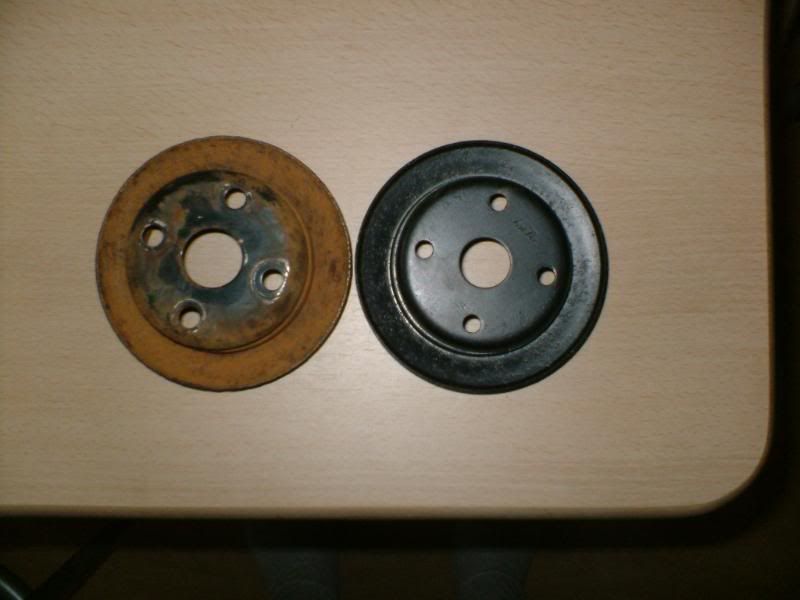

are there 2 different size waterpump pully's on a pinto
i have ordered 2 off ebay so far and neither fits.
its the centre hole and mounting bolts are too small.
and doesnt seem deep enough
cheers gavin

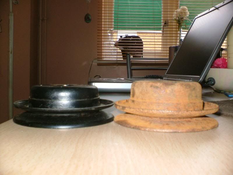

gavin174
posted on 17/7/09 at 03:10 PM Reply With Quote
the dimensions are
new
centre hole 20mm
mounting holes m6
depth 35mm
diameter 110mm
pinto
centre hole 25mm
mounting holes m8
depth 40mm
diameter 110mm
sorry for the poor photos the pinto one is the rusty one.

gavin174
posted on 17/7/09 at 04:34 PM Reply With Quote
sorry for the vague posting
i have just finished a 27 hour shift at work!!!!
its the bigger of the 2 i need with the 25mm centre hole.
