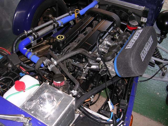

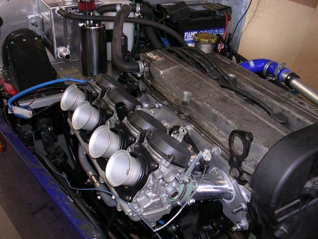

bob
| posted on 18/7/09 at 09:05 AM |
More cleaning bit of paint and final fit.
