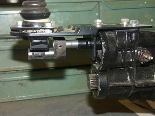

bonerp
| posted on 25/3/04 at 02:38 PM |
try this
bonerp
| posted on 25/3/04 at 02:39 PM |
and this
bonerp
| posted on 25/3/04 at 02:40 PM |
You basically cut a hole out of the backplate of the type 9 box then slot it in like you do the stick, then bolt the stick to the new platform.
Hope this helps
Paul
