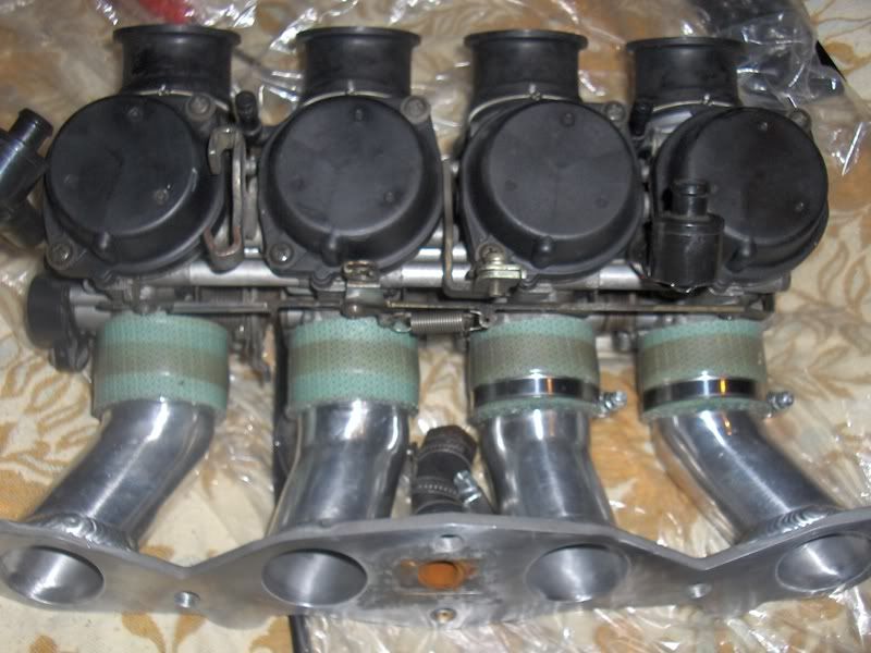

I have some. Quality is excellent. But as said not cheap.
[img][/img]
Dan

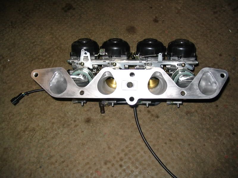

here's mine (late model ZX9R carbs for an efi pinto head)
Originally posted by MikeRJ
Quality of fit and finish looks excellent. Quality of design less so.
are you meaning the fact that they didn't re-space the carbs ?
I asked them about that, and they recon it doesn't make enough of a difference on a road car.
but I fairly sure they'll make the manifold to your spec. if you ask them to....
