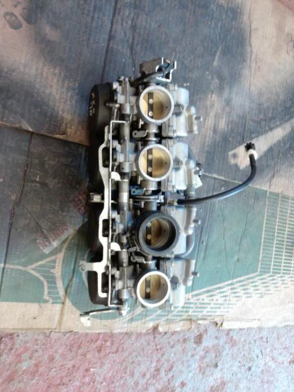

Hi all, i just got these bike carbs off a mate dirt cheap he says there off a ZX6 does that look right?

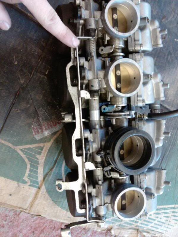

Can anyone tell me what these two parts are for, i'm pointing at them in the pictures.

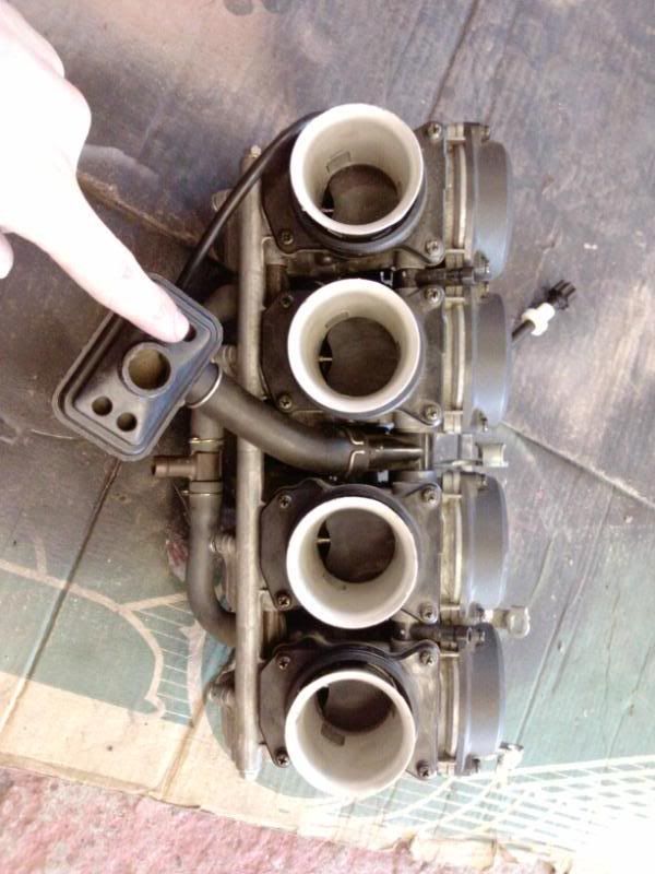

In that last photo what are the black things down the trumpets? choke flaps?

1st pic is the choke mechanism
2nd pic is a breather of some sort

They are Honda.
cbr900 fireblade if 38mm ish or cbr 600 if smaller

The black things down the trumpets are the slide pistons... They slide up and down accourding to the flow through the trumpets and the needles are attached to the end of them.

zx6r carbs have the throttle quadrant on the end

my cbr600 carbs have the throttle quadrant on the end not the middle???

There Kawasaki carbs
Mine's central

I still say Honda.
Stick cbr carbs into ebay and you will see carbs like yours.
Do the same for zx6r or others kwak's and I cant see one set like yours.
What do they measure at the inlet dia ?

I've got 3 sets of zx6 carbs and none look like that. I agree that they are probably CBR600 carbs.

The inlet dia is 38mm and th manual that unclefista posted is definetaly the one for the carbs i have so they must honda ones cheers for your help, i'l probably have a load more questions when it comes to jet sizes etc
