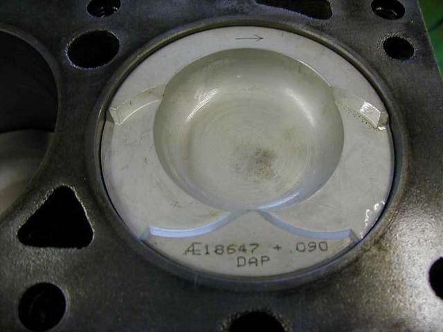

I have the 1300 x-flow with A3 cam and +90 pistons
  x-flow piston close up
  x-flow valve seats 2
Head is polished and the hardened seats fitted to run unleaded.
Engine runs well.
