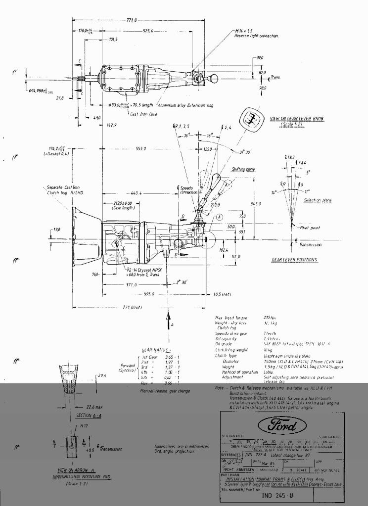

I've got a proper ford drawing of one on the computer at work - I got it form someone on here, but if no one else can find it I'll dig it out on monday
in the mean time:
what other sizes do you need ?
[Edited on 25/9/09 by mcerd1]

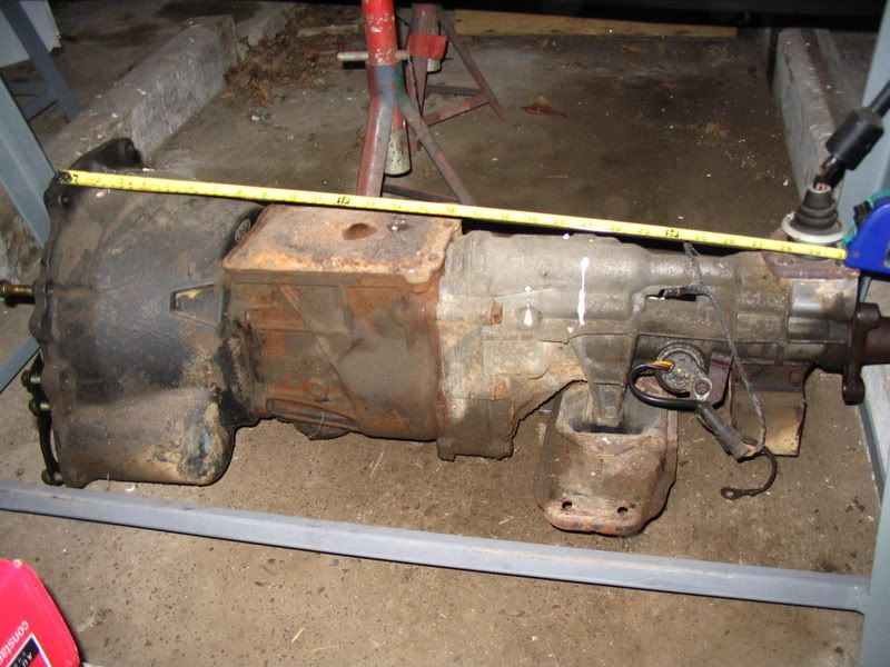

the bellhosing is about 7" long (std iron 4cly one from a pinto)
the bellhousing is about 14" wide across the starter (the release arm might stick out a little more)
the whole lot (with the bellhosing) is 31" long
the box itself is about 13" of that and is just over 7" wide and 10" high
the tail housing is only 4.5" wide
mcerd1
posted on 25/9/09 at 05:58 PM Reply With Quote
thats the drawing, i wonder how well my measurements stand up against that
