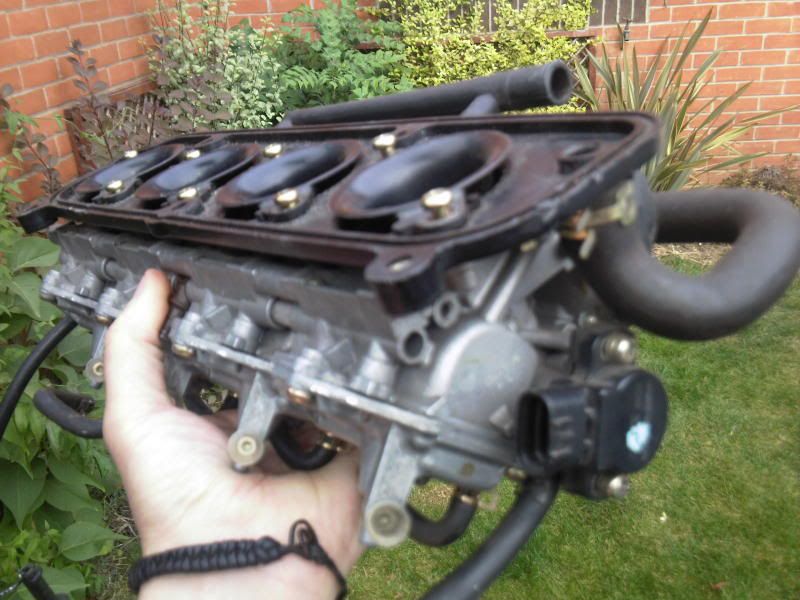

will121
posted on 26/9/09 at 12:16 PM Reply With Quote
ive got a spare set, they are ZX6 ones think J model with the TPS, they have the airbox trumpet back plate, but with a set of 4 of the shorter trumpets as i used the longer pair in my car to have a matching set.
you can have them for £30 + postage which i think is about £7 but will have to weigh them if you are interested

col
posted on 27/9/09 at 04:51 PM Reply With Quote
Hi Will, in your picture,where your thumb is, what is attached to that pipe outlet ?
