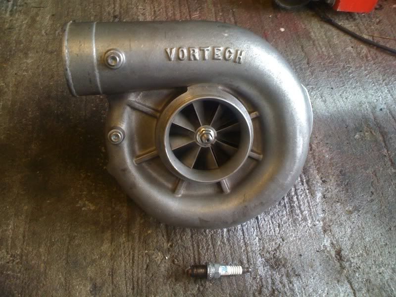

I currently have a to4e fitted but always wanted to try supercharging a rotary so i'm going to give it a go over winter.
Not really sure what to expect but i will report back.
This is coming off

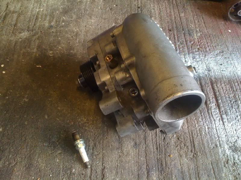

and this little beast is going on!

there isnt that much room in my little engine bay, also, its not about more power, ultimately i wont get more power but hopefully it will be a different power, but its more about having a play and the supercharger is borrowed from a friend

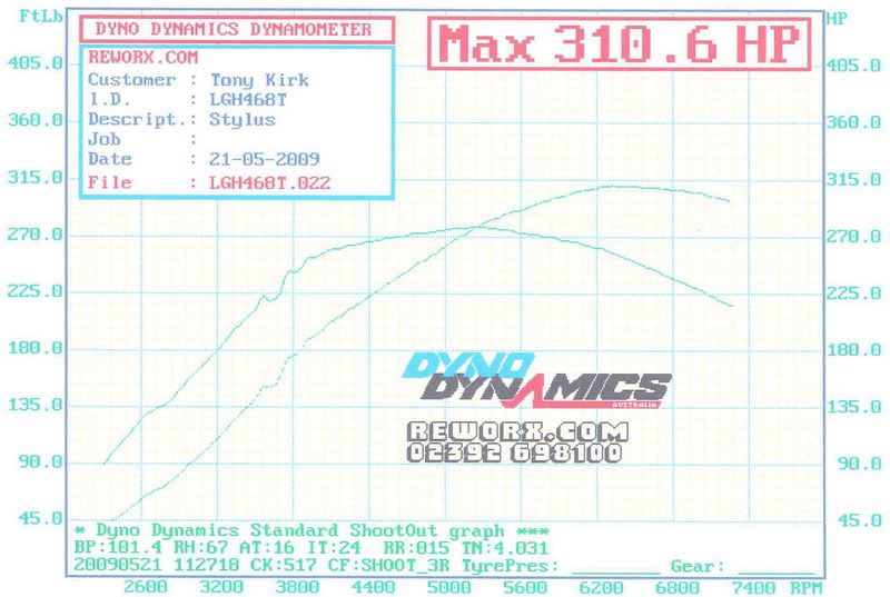

you have a point but unfortunately, especially with rotaries, the more freeflowing the turbo is the bigger the kick and you cant really do much about it, its ok with small turbos but you are then limited with the power.
here is one of my old power graphs, the higher line is BHP at the wheels at 0.7 bar boost.
As you can see its quite a smooth power curve but was still an animal mid corner especially at higher boost levels.
I am going to have a play at controlling the boost without changing pullies and belts. Using a wastegate and a boost controller (which i already have.)
