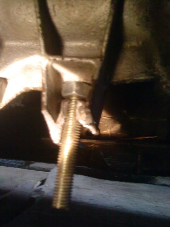

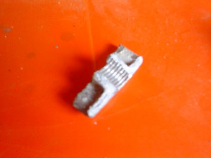

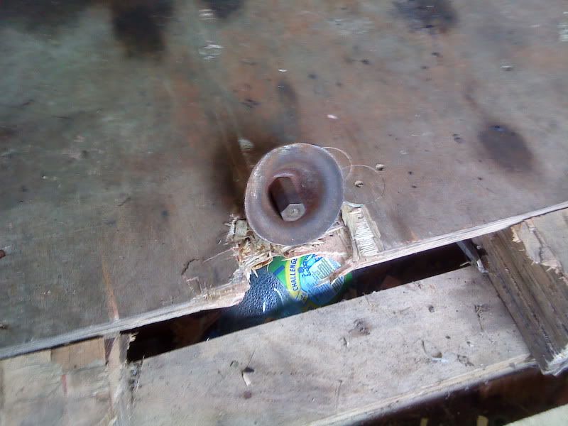

I caught the coney gearbox mounting thing on the way into my barn thus:
And it smashed the gearbox mounting:
And here's my attempt at a bodge to get the car mobile again!
So, get it sorted before you do the same!!!
