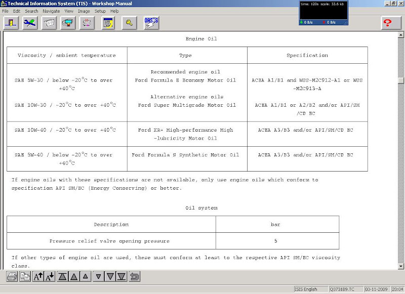

radom
| posted on 3/11/09 at 07:09 PM |
here's what i've found in TIS
http://lh3.ggpht.com/_O3xyB4d07ko/SvB-3N8GOEI/AAAAAAAACCs/3O3UuJBdvw8/s800/oil.JPG
