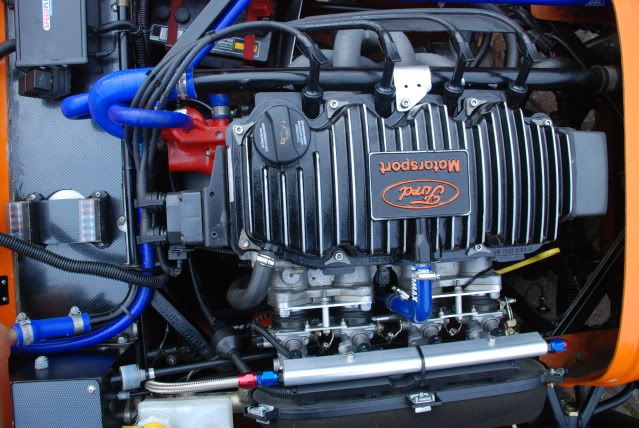

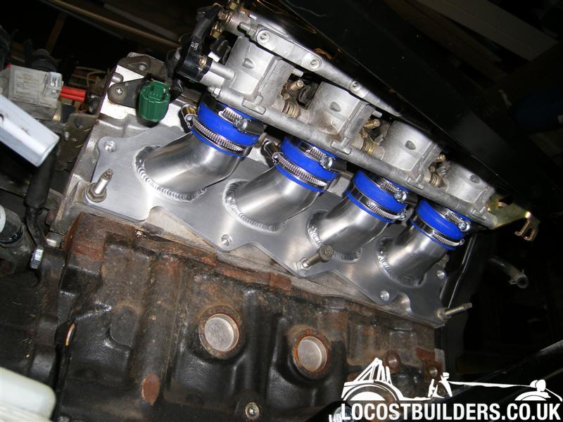

Hi, It's N/A using a ferriday bottom end (so pistons are pocketed).....The head is ported and runs a fairly lairy cam and solid lifters........But the GSXR600 set up seems to run it perfectly....I actually think I could get more top end if I tried, but I'm enjoying the torque too much :-)
Some photos if it's any use:
Engine 1
Engine 2
