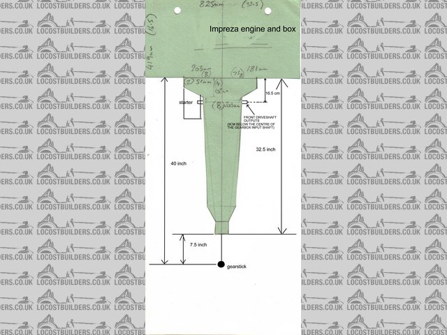

meany
| posted on 20/11/09 at 06:55 PM |
that was my plans originaly.
if your going 7-type, its way to wide to keep the shape looking ok.
ive got the dimensions on a drawing i did,
might be in my profile pics..let me have a look for ya.
here you go.. sizes are not exact, but good enough to work things out.
  plan view dimensions subaru impreza
  impreza engine rough dimensions

oadamo
| posted on 20/11/09 at 07:16 PM |
[Edited on 20/11/09 by meany]
thanks that just what iam after, does anybody no the sise from the bottom of there chassis to the top of bonnet.
