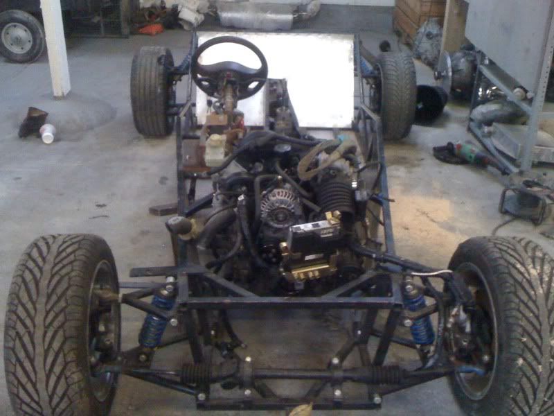

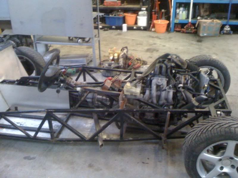

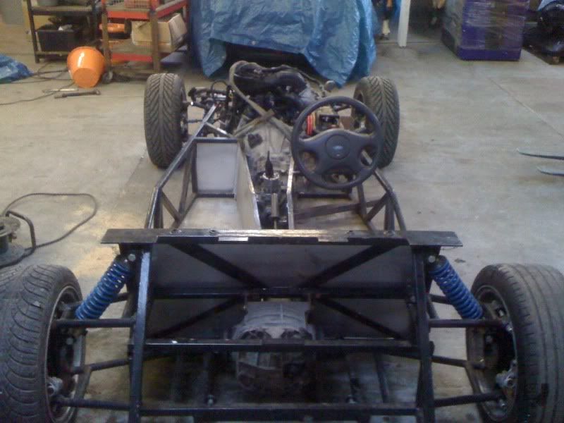

RX8 Powered Tiger Avon is Born
My cousin and I started our next project today. He has sourced a Tiger Avon rolling chassis. We like anything rotary so the next thing was to throw
in an RX8 engine and 6 speed box (higher power model)
The car is going to be a track car and is unlikely to be road registered but we will see how it goes.
Pics taken with my phone so not brilliant.
We will trying to put the engine as far back as possible and keep things fairly light. I reckon the RX8 engine should be a good package with 230 odd
bhp and 180 ftlbs and a 9500 rev limit.

Oh holly crap That is going to be a scary beast....
pity the rotarys got such a big bellhousing....cut some of the passengers footwell away and that should do for the starter lump.
[Edited on 2-1-10 by mangogrooveworkshop]
Richard Quinn
| posted on 2/1/10 at 09:16 PM |
That looks as though it fits quite well. How much chassis chopping have you had to do for the bellhousing?
Antnicuk
| posted on 2/1/10 at 09:17 PM |
we have already chopped an inch out of the passenger foot well, we are also going to shorten it by 4 inches to allow for the starter. It doesnt
matter if the passenger is uncomfortable

locoboy
| posted on 2/1/10 at 11:06 PM |
What about the height?
It looks WAY to high.
Locoboy
bimbleuk
| posted on 3/1/10 at 06:01 AM |
At least its just the inlet gubbings which is far easier to modify than a cylinder head from a straight 4. The engine mass should be lower with the
rotary as well?
