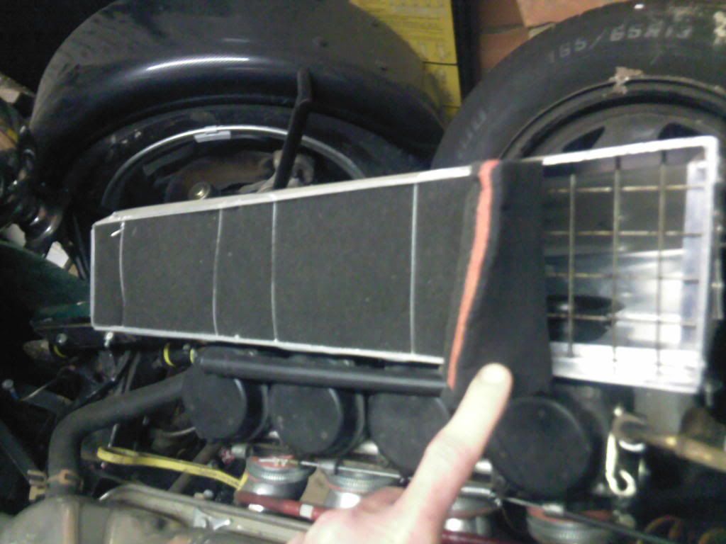

will121
posted on 18/1/10 at 05:31 PM Reply With Quote
this is what i done on my ZX6 carbs to keep under the bonnet
dan8400
posted on 18/1/10 at 08:04 PM Reply With Quote
Nice tidy job. Is the filter inside or are you having a cone style one somewhere else?
will121
posted on 19/1/10 at 05:46 PM Reply With Quote
the top is covered in pipercross filter material.
